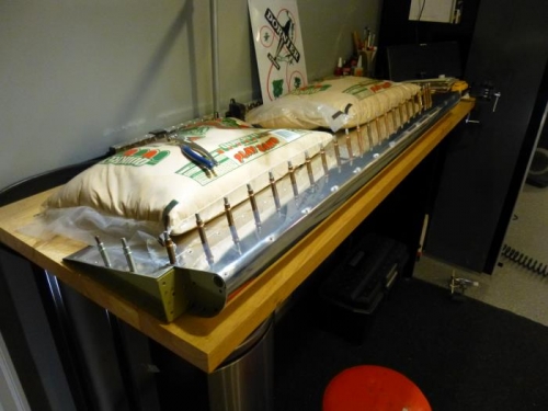

Aileron assembly #3
-Installed / riveted the main aileron ribs. Riveted the top flange to aft skin & spar (both ailerons).
-Weighted the aierons down on a flat / straight surface. Riveted the bottom nose rib, blind riveted the counter weight pipe in place,
-Riveted the bottom of the main ribs to aft skin.
- Blind riveted the bottom skins to spar
Weighted down & being riveted.
