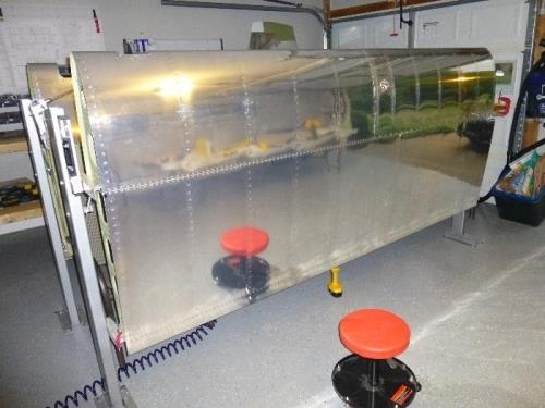

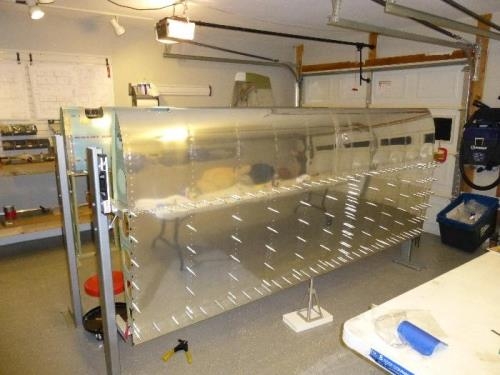

- Riveted on the top wing skins with the help of fellow builders Bill, Gordon and his son John.

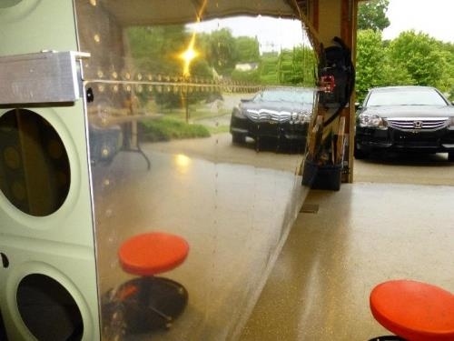

Everything cam out perfect except a main spar ding which I buffed out & alodine coated.
At this point, Bill & I have one more 2 hour rivet session and both wing sections are ready to come off the stands.
Ready for riveting the skins
Left wing skins all done
Look how smooth, Man!!!! thant's nice
