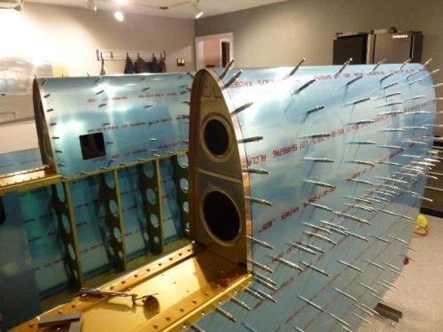

- Finished drilling the right tank reiniforcement strip.

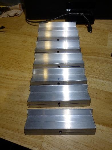

- Center drill the fuel tank Z-brackets. Offset the bolt holes on the inboard most bracket by 1/16, (away from the bracket web) to allow the use of a socket wrench, should I ever need to remove the tank in the future. (fingers crossed).
- Match drilled both leading edge assemblies.

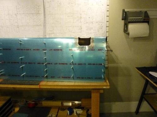

- Cut the Landing light cut-outs in the leading edge for the DuckWorksAv.com landing light brackets & drilled the respective ribs."
Right reinforcement strip drilled to LE
Z- Brackets
Z- Brackets
