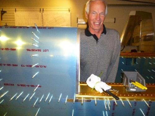

Dad helping me align the tank strip

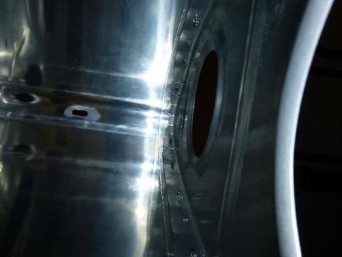

Internal tank reinforcemnt strip holes
