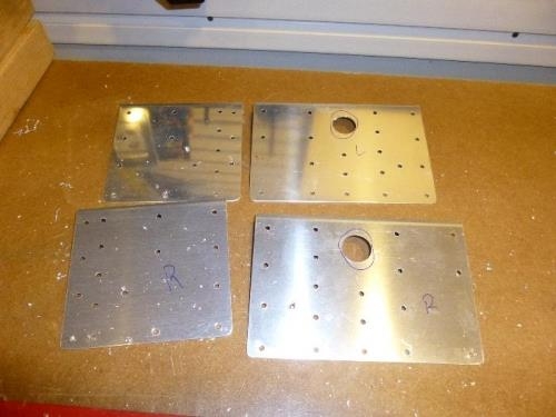

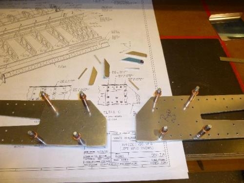

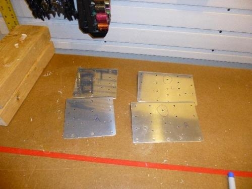

"Thanks Van's for not including DWG 38 with the wing kit & sending me on a wild goose chase to verify measurments in the preview plans!!!!!!
-Cut inboard rear spar doublers per DWG 38 after verifying the dimensions with Peter D. Who has a current DWG 38 since he is working on the finishing kit.
-Match drilled outboard doublers using the spar as a guide.
- Marked & rough cut outboard doublers for aileron push rod pass-through.
-Deburred all doublers."
Hope this is cut right.
Match drilled
Match drilled
