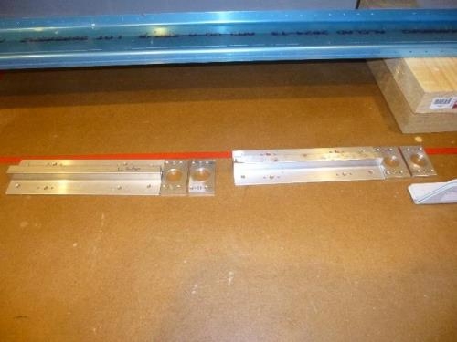

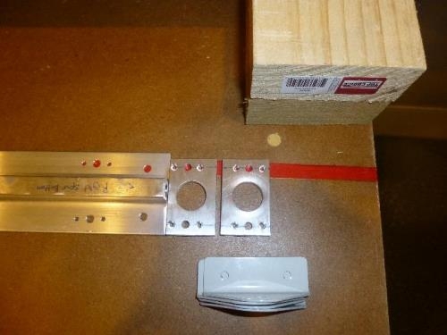

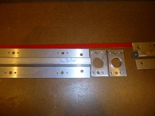

Finished the tie down brackets / spacers
"-Final driller, bracket and spacers to main spar.
-Drilled fro plate-nut attachement.
-Deburred everything.
Note: When fabricating parts like the spacers and counter-sinking etc. Use a drill press to make sure every hole is straight."
Finally complete
