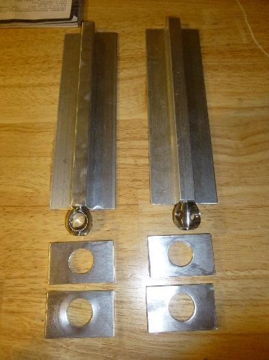

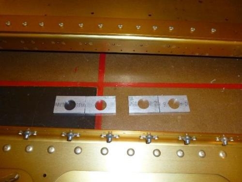

-Fabricated the (4) W-726 spacers & bore a 3/4"" lightening hole (I dont have a 1"" unibit) Better put that on the shopping list.

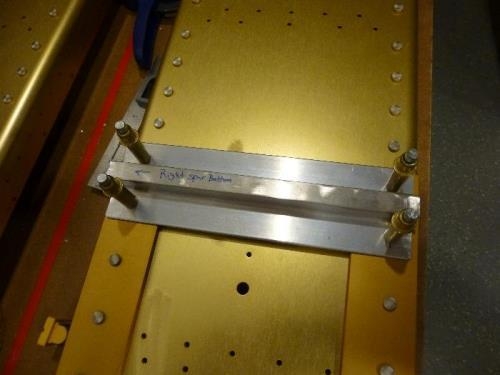

- Tapped the backet for 3/8-16 tie down eyebolts... I got the nice SS tie downs from Cleaveland tool. These are super nice! & way better looking then putting cheap Home Depot hardware (as suggested) on $100K+ airplane.. IMHO."
Spacers
Spacers
Polished & Tapped
Polished & Tapped
Fitting to spar
Fitting to spar
