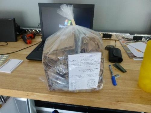

Brief Description:  Inventoried Hardware & Started CS on main Spare

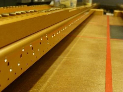

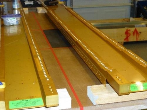

The Hardware inventory is huge in this kit. It seriously took Kim & I about 2.5+ to organzie this all the hardware, make labels and organize in it in the storage bins. After wraping up some final shop cleaning, I finally got studying the wing plans & direction intently. I counter sank the tops of both of the main spars for tank attach plate-nuts / nut plates (WGFF on the Mil-Spec name). I counter sank ONE knotch past flush to account for spot priming with AKZO. I'll finish coutersinking the bottom of the spars tomorrow.
