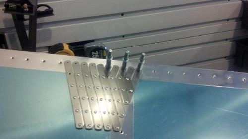

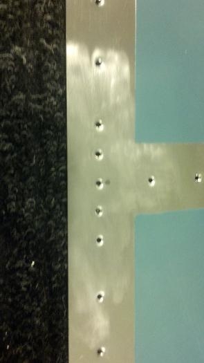

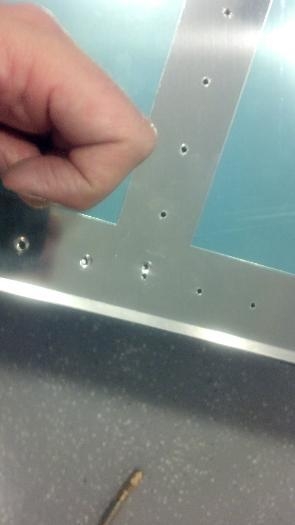

Damn pneumatic squeezer... be very very careful!!!! I punched the VS skin like I did the rib in the previous mistake.. The fix was quite simple, learnd for the folks on VAF... placee a rivet on either side of the FUBAR and move on. I elected to do the same rivet pattern on the other side of the VS. it's definately not required.... Just me being a perfectionist. I want my craftsmanship to be top-knotch. Here's the f- up and the fix.... Craftsmanship is recovering from one's mistakes and making it look like the plan.... JB weld, rivet fan spacer and a drill. I actually made my VS stronger by making this correction.
