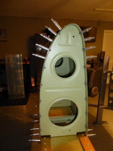

"Today, I finally riveted in the right wing inboard leading edge rib with the fuel tank splice strip. I also installed all of the plate-nuts on the splice strip.
I ordered all stainless steel hardware for the tank final install (MS 24694c5) #8 structural screws. a whole $8.00 for 100 screws from ACS.
Also, ordered #6 Stainless screws & tinnerman washers for the wing tip install. I'm planning on using Click Bond platenuts on the wing tip & for the Tip landing light lenses. :-) I have AeroLEDs SunBeams & the Pulsar NS 90s going in the tips... In the leading edge, I have AeroSuns. Hopefully, this thing will look like a jumbo jet when I turn on all of the lights. Pricey lights but should NEVER have to be replaced as they have a 50,000 hour life span. At my planned rate of flying that equates to 250 years or 25 full engine overhauls running the lights at all times.They should long out live the airframe itself."
Right LE
Right LE
