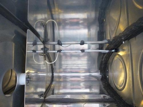

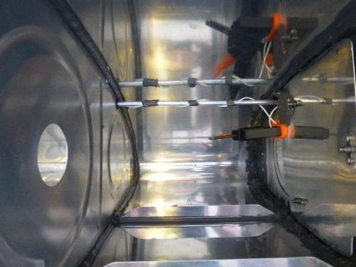

Brief Description:  Final Cap Sender Install
Last proseal session before the rear baffles go on.
- Reshaped inboard sender plates to fit the fat fillets on the rivet side of tank ribs.
- Cut wires to lenght, crimped connectors.
- Sealed & installed the inboard sender plate connection
- Final installed inboard sender plates.

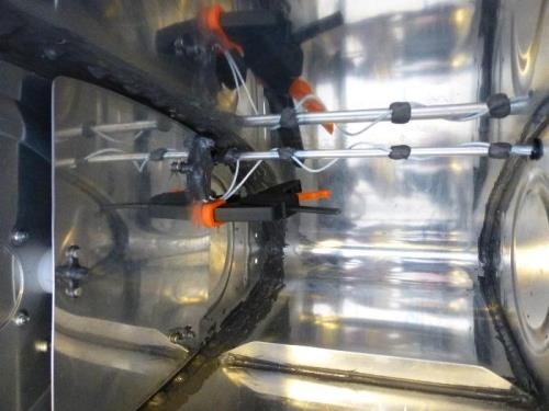

- Secured wire to vent tube using proseal as a fixtures. I let the proseal set up a bit before wrapping it around the wire & vent tube... this worked out very well.
- Top coated the left tank leading edge reinforcement plate & fillet.
- Encapsulated exterior out-board LE rivet heads.
- Topcoated internal ventline AN fittings to prevent loosening."
Left inboard senderplate
Right inboard sender plate
Outboard sender plate wire supports
