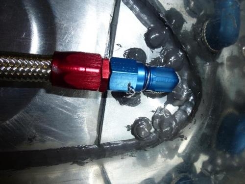

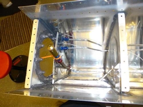

Today was fun tiding up & final installing, sealing & torqueing all of the AN fittings.
- Torqued & safety tied the flop tube assembly.
- Installed the completed flop tube assembly in the right tank cleaned, sealed, torqued.
- Installed the vent line bulk head fitting in the right tank. cleaned, sealed, torqued etc.
- Final torqued vent line fittings in both tanks.

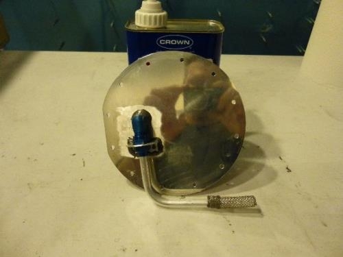

- Fitted, assembled cleaned, sealed, torqued etc the left fuel tank (standard fuel pick up). This fuel pick up / access panel assembly is a bit of a PITA to get in place with the domed / sealed plate nuts but is definately doable."
Flop tube bulkhead
Flop tube bulkhead
Vent Lines final installed
Standard fuel pick up
