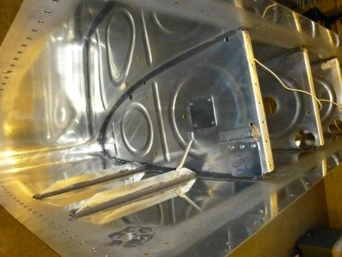

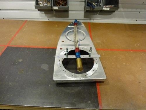

"Today I fabricated the anti-hang bracket in the right tank for the flop tube and instaled / sealed / top coated the access panel reinforcement ring with the domed plate nuts... Total overkill.
Also installed BNC connectors / sealed with a big ol' Hershey Kiss of proseal."
Internal anti-hang
Internal anti-hang
Access panel anti-hang bracket
