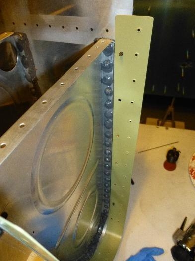

I had some touch up work to do on the left tank.
- A couple rivets I needed a hand bucking in the top front of the tank and a couple replacement rivets in the leading edge assembly I didn't catch when we originally riveted it together. Bill swung by to give me a quick hand bucking.
- Started assembling the inboard rib with the attach access plate reinforcement ring, attach bracket doubler, sealed plate-nuts, etc.
- Spent quite a while encapsulating shop heads with pro-seal.
- I'm so glad I thought ahead and taped off the area where the leading edge / fuel tank joint plate strip sits. I clecoed it in place to see if I could add a bit more of a fillet... Dang its a tight fit!!!"
Joint Plate Clecoed In place
Encapsulaions
Encapsulaions

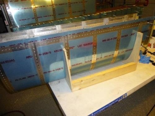

Top of the tank
Top of the tank
