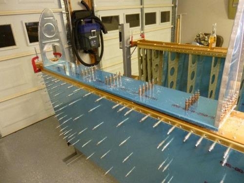

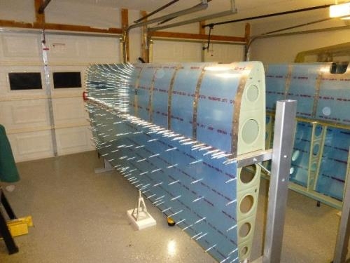

What an awesome evening of air-o-plane work! I finished assembling the right fuel tank & fitted it to the wing... Once again, this tank fit absolutely PERFECT, just like the left tank. I got the whole tank match drilled and then pulled off the leading edge assembly & dismanteled the tank leaving the end ribs & rear baffle in the "perfect fit" position while exposing the Z-Brackets for match drilling to the baffle. I'll have this tank ready for it's first sealing session by the weekend. It seems to be moving much faster then the left tank! I'll countersink the skin for the rear baffle tomorrow & start hole deburring.
All Assembled & ready to Match Drill
The perfect fit.
The perfect fit.
