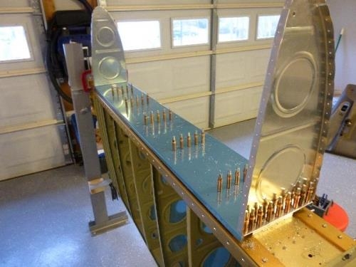

- Assembled left tank with the rear baffle & skin stiffeners. Mated to the tank to the wing. The fit was absolutely perfect!

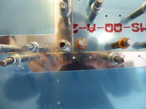

- Match drilled all tank ribs, stiffeners and leading edge / tank reinforcement strip. Match drilled in-board most z-bracked to the #1 tank rib / rear baffle.
- Remove the leading edge and match drilled the out-board most z-bracket to the #7 tank rib / rear baffle.
- Dissasembled the tank leaving the #1, #7 ribs in place on the wing holding the rear baffle in the ""perfect fit"" location & I proceeded to match drill the remaining z-brackets using the rear baffle as a guide.
-Reassembled tank and countersunk the skin for the rear baffle attachement rivets.

Left Fuel tank Assembly
Left Tank Fit to Wing
Rear Baffle - Z-Brackets Drilled
