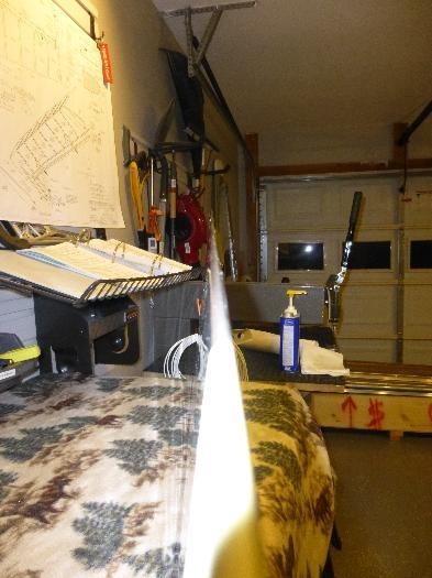

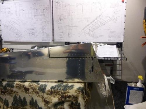

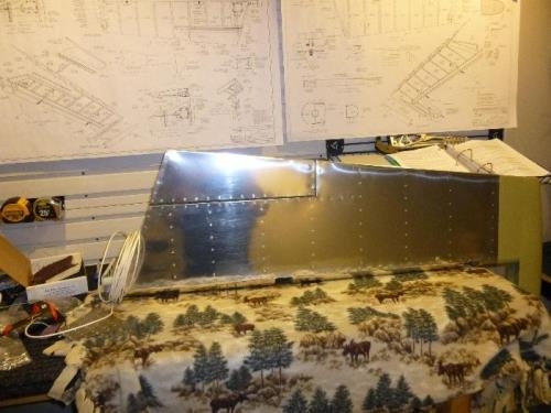

With the trim tab all done, it was time to final attach the servo and push rod control arm. I really wish I had not trimmed the control horn per the plans for electric trim. I would have used the outer holes that were trimmed e plans.I had to lengthen the slot for the pushrod. It's trimed almost to the edge of the doubler plate. Not wanting to trim further, I elected to put a very slight bend in the steel push rod to avoid any chance of interference.. I also bummed some stainless hinge pin from Bill so I could final attach & safety wire the pin in place.
Bottom
Bottom
Top
Top
Looks straight to me :-)
