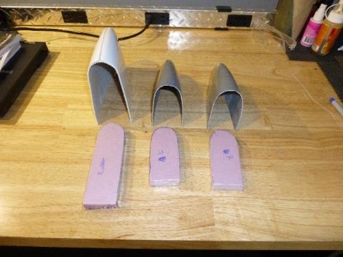

- Trimmed the fiberglass HS & VS tips... Messy!! The belt sander is the key here to keep the tips square.

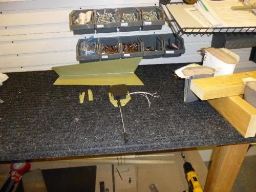

- Preped and primed the elevator trim servo access plate and assembled the servo mount(s).
- Primed an extra trim tab and related parts. I'm not sure if I'm going to fab up some ribs or use the trim tab with folded end closures.

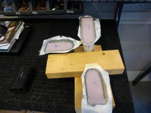

-Then It was on to the fiberglass tip closures. Cut and formed temporary foam ribs covered with packing tape so the west systems epoxy doesn't bond the ribs inplace. I used a little hot glue to keep the ribs in place. I also place the ribs about 1/8' in from the edge to create a nice concaved closure.
- With the ribs in place, I layed up the first layer of fiberglass & let the lay up cure.
EDIT: If I were to do this first lay up again, I'd definately put a layer of ""peal ply"" between the packing tape covered rib & the layup getting in there to scuff the surface for additional lay ups kind of sucks. Lesson learned :-)"
Primed & assembled trim tab stuff
Foam Ribs
Foam Ribs
First ply lay up
First ply lay up
