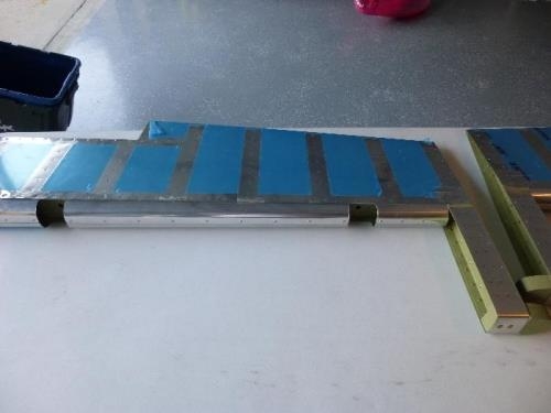

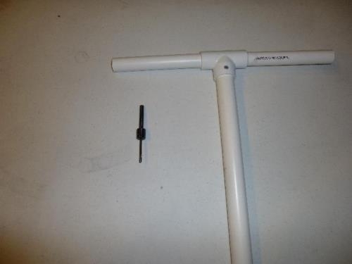

I rolled the leading edge of both the right and left elevator... This task for mr was much easier than the first time (with the rudder). This time around I used an in & out deburr tool rather than taking the whole leading edge appart after match drilling... This little tool is freaking awesome!! Well worth the $50 bucks for this task alone. Just watch for burrs between the mating skins.The edges came out really nice. There is one section I may re-rivet later depending on a re examination later. The skins are not as tight together As I would have liked. But I will sleep on it & revisit it later.
Tools of the trade
Tools of the trade
Left Side Done
Left Side Done
Both Done
Both Done
