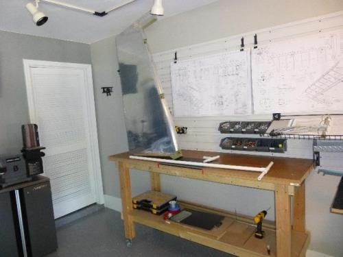

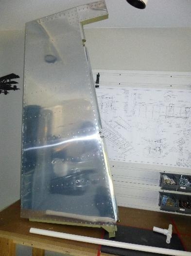

Brief Description:  Rudder Complete (for now)
"Okay ""rolling"" the leading edge of the rudder is NO easy task!!! I concurr with others on this one, it's a total PITA and is time consuming. I made a PVC rolling tool out ot the excess PVC I bought for the rod end tool. Same concept as the rodd-end tool, but a bit larger. Worked like a charm. I had Kim twist the handel while I made sure the skin didnt lift against the spar & leave a crease. after alot of hard work (about two hours)... It came out pretty close to perfect.
