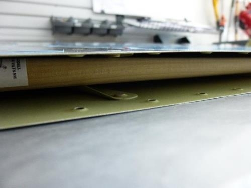

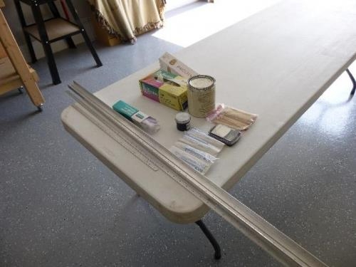

Bill came over to help me with my first pro-seal session. We countersunk the AEX wedge, broke out the pro-seal and slapped it inplace. We put decent sized globs on the ends of all of the striffeners. I was going to put some RTV on the stiffeners but it was alot easier just to use the pro-seal plus no chemical interaction etc... Cleocoed the edge between two angles that I match drilled to the edge a couple days ago. The whole process is really not a big deal like some folks make it out to be.
Supplies
Supplies

1/2" dowl rod holing the edge apart

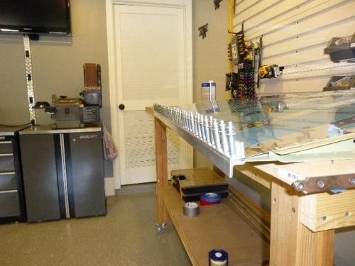

The wait begins (4-5 days)
