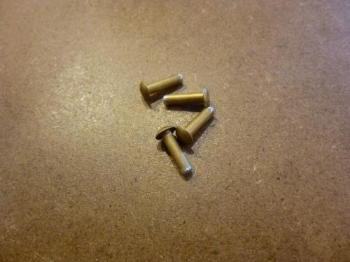

- Started riveting the rudder skeleton. First were the upper two spar reinforcement plates & nut plates. All went well here; personally, I didn't like the rivet call out in the plans the (-5) were too long but the (-4) were a tad too short to make a good shop head. Well, in denial, I went ahead and used the -5s bent two over and had to replace them but over all, I was left with some pretty tall but good shop heads.

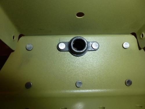

-Next came bottom reinforcement plate, shim, bottom rib, nut plate and rudder horn combo joint. Here again I was troubled by the rivet call out in the plans. The plans call for a univeral head -7 rivet but that was too short in my opinion as this is a very critical / high stress area.. I tried the - 8s and they were too long and would have bent over. I didn't want to play russian rulet; try setting rivets in such a critcal area just to get a look-see and end up drilling them out. I went ahead and shaved 1/32"" off of the -8s, essentally making a AN470 4-7.5 rivet. these came out PERFECT.

Custom Rivets
Custom Rivets
Rudder Horn Malfunction- Junction Riveted w/ Custom Rivets
