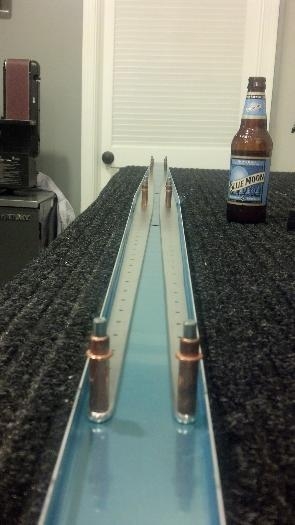

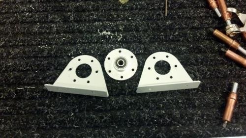

" Broke the edges" / shaped the two HS609PP spar reinforcement bars. They now fit nice and flush. Match-drilled spar / reinforcement bars, hinge brackets. Matchdrilled, deburred, primed and rivited the HS 411 bearing assembly. Enlarged HS 411 mounting holes to # 12 and HS708 rib connection points to #21 per plans. Started working on the front spar also. Matchdrilled HS 702, 710,& 714... Got ready to make the required 6 degree bends on 710 & 714. But ran out of steam. Another day awaits.
Shaped HS-609PP(s)
Shaped HS-609PP(s)
HS 411 Assembly matchdrilled & primed
