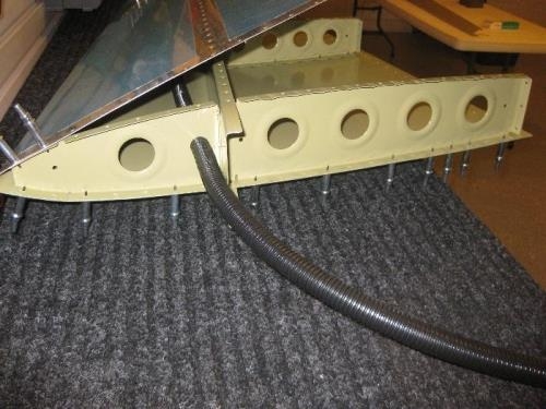

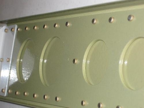

Riveted the main VS spar, riveted VS 704,705, 706 & 707 to the front spar, installed the electical coduit and clecoed the skin on. Waiting till tomorrow to rivet on the skin & rear spar. A couple tight area rivets on the front spar )(VS704-705 intersecion) gave me a few headaches. I had to drill them out & reset them a couple different times becase I didn't like the way the shop head came out. I couldn't seem to get the angle & pressure right while bucking. I really wish my tungsten bar would get here already. (it's on back order for some reason. Overall, I'm happy with the way today's work came out. All of the rivets ar within tollerence & pretty consitant ( I might add)...
Main spar riveted
Main spar riveted
Front spar & ribs rivet.
Ready for the skin a final assembly (my part two
