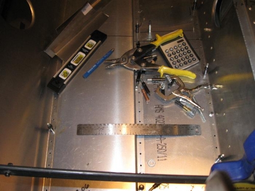

Brief Description:  Spar placement
My plan is to replace the landing gear channel. There is a good 9mm between the rivet hole and the edge. On the new channel I will drill the holes at 7mm with a total pick of of 4mm. Then move the rear attachment channel back 2mm for a total of 6mm. Will call Zenith tomorrow and talk to Roger about my plan.

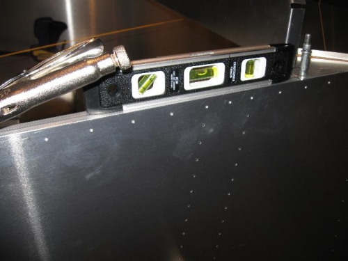

Centerline of fuselage and top of firewall is dead on.
All my levels are dead on. The rear skins, the forward skins and the firewall.
