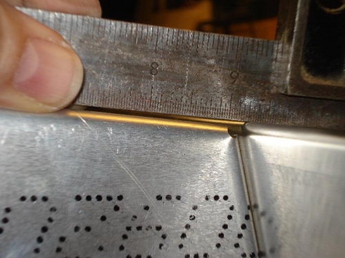

Bottom of Wing Work
Not sure what exactly is going on. All the parts measure correctly. An Autocad drawing make me think the drawing dimensions are off by about .075". Zenith said no problem with shims of that dimension. After riveting with shims the bottom is good.
The gap on the bottom trailing edge
The channel measures okay.
Alignment of top is perfect.
