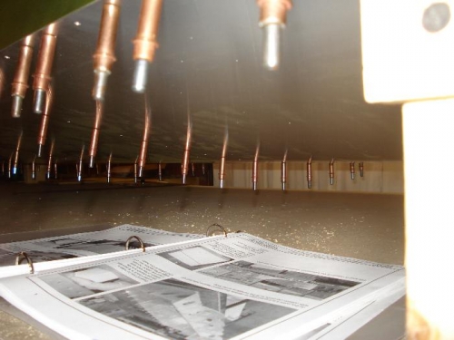

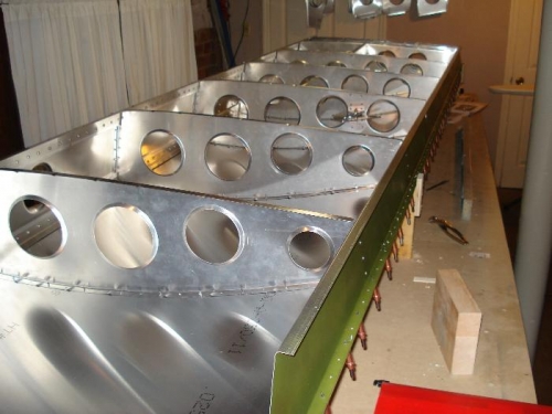

Brief Description:  Top skin drilled. Bottom skin next.

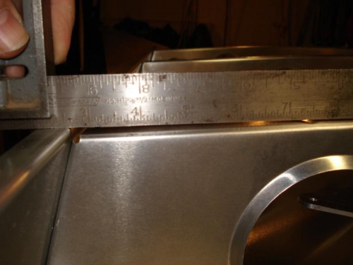

Finished up drilling the top skin. Flipped the RH wing over and cut the blocks to level it out. Notice the gap caused by the height of the Rear Rib and the channel. Not sure what to do? Maybe shims or rebend the flange. I guess I will call Zenith for a recommendation.
To Shim or Bend... that is the question
