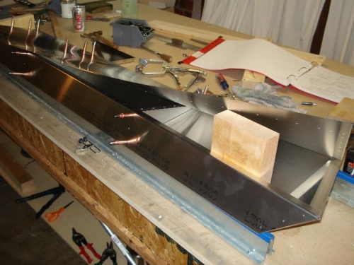

Brief Description:  Aileron Construction
Not happy with my work. After doing all the drilling and Clecoing I notices the leading side of the Aileron is not straight on the top, out about .125". Not bad, but I didn't see it coming. Next time I will mark the drill line on the top flange to assure the straightness. Miss drilled the control arms. Need to make a couple more before I'm happy.
