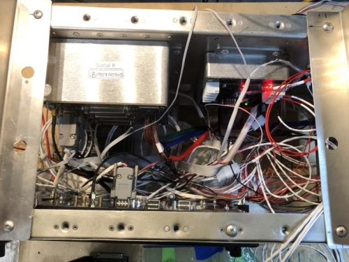

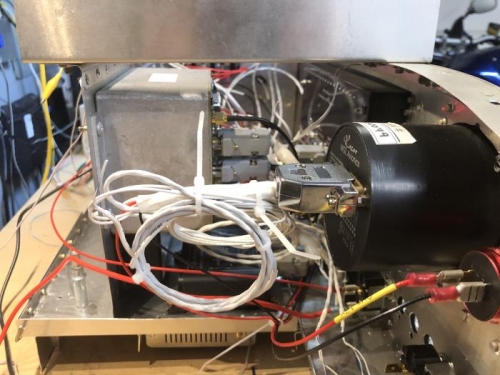

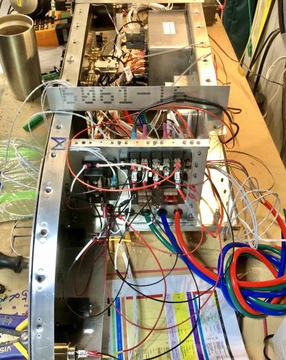

Number of Hours:  3.00
Brief Description:  Connect and test VHF radio
