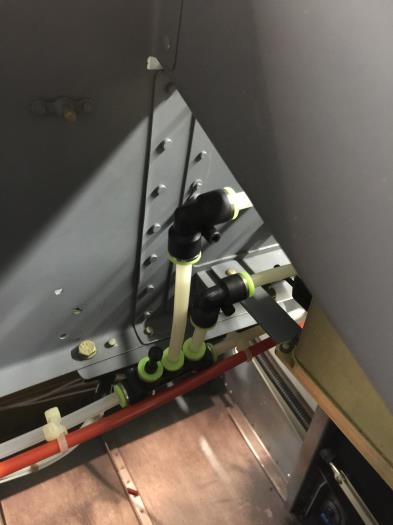

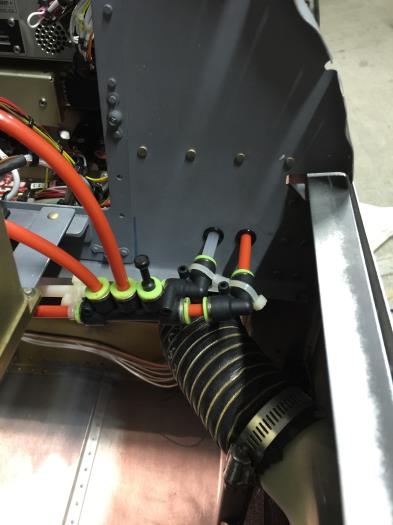

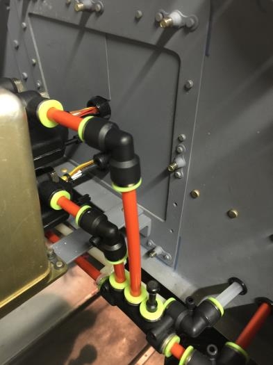

Brief Description:  Reinstall of AHRS Pitot Static lines
Didn't like the amount of tension that was on the pitot static joints where the connected to the AHRS units. Reinstalled the lines with an added 90deg fitting to remove the tension in the lines.
pitot before
pitot before
pitot after
pitot after
static after
static after
