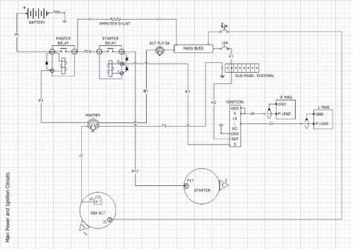

Been working at home getting the electrical system all laid out--so this is a catchup entry.
Electricity isn't my strong suit, so this has been a learning experience to be sure. But, I've pored over the blueprint for the basic design to understand how it all works and have expanded the design to include the items I want to have. I'm fairly close to having a design is that almost final. (I know better than to say final ;-)
I've been making schematics and tracing the flow of power to make sure I have it right. I'm posting another eye-chart--not really useful like this but if you want to see it, let me know. It is the schematic I made for the power and ignition circuits. Next I'm going to draw the schematics for the main and avionics power distribution systems.

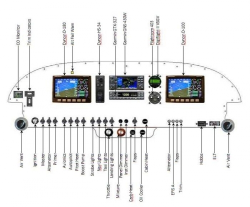

Oh, I also put up a pic of the instrument panel layout that I think i am going with at this point.
