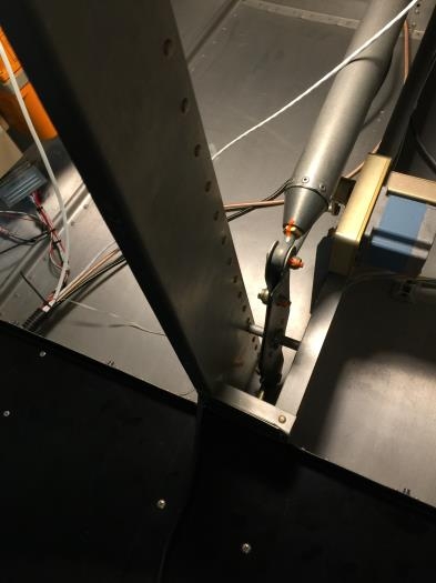

Brief Description:  Reinstalled Sticks and Push/Pull Tubes
Reinstalled both the pilot and copilot sticks and the stick-to-stick linkage. Also reinstalled the push/pull tube from the stick control column to the elevator bellcrank aft of the baggage compartment.
