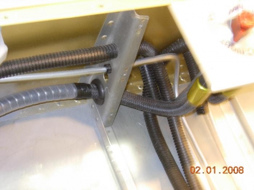

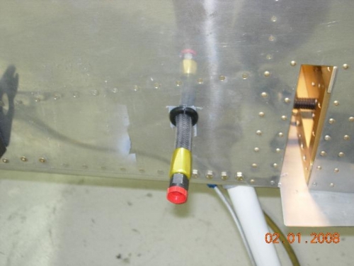

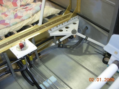

Received my order from Spruce today of elastic grommets and anti-chafe strip.
Installed the grommets where the fuel line passes through the fuselage (and to the wing tank) and also in the kickplate mounting bracket passthroughs. Installed anti-chafe strips where there is a possibility of the lines rubbing against the wing spar or the landing gear mounts.
I've attached a few picture showing where.
Fuselage Passthrough
Kickplate Bracket Passthrough
Overall Line Routing (Left)
