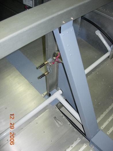

Brief Description:  Flap Actuator Housing
Got the side covers fitted and primed today. Also finished the forward and aft tunnel covers (left and right of the triangle in pic).
Installed conduit through the aft tunnel cover so that wiring for actuator is hidden. The conduit enters the housing at the bottom, back right corner of the housing. I'm pleased with the location and routing--keeps the wires away from the mechanism.
I also temporarily installed a grounding point on the right side of the aft brace. It's clamped in place for now. Tomorrow, I'll check that I can get a screwdriver onto it easily. If so, I'll rivet it into place.
