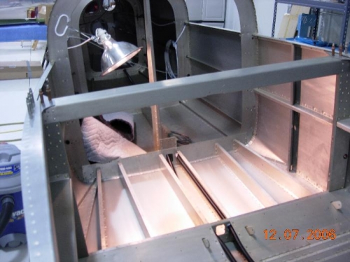

Finished the static air line installation. Pretty simple, really, but a bit of a pain to get to. I bonded cable clips to the bulkhead and ran the static line through them (white bits in the pic). Will make for easy maintenance later, if needed.
Backriveted nutplates onto the ELT and Strobe power supply brackets. (No pics). And determined where the brackets will be located.
Prepped the baggage area for installation of the step kits. Just removed the floor and side/back walls. Will have to bore some huge holes in the fuselage to install them. Ugh.
