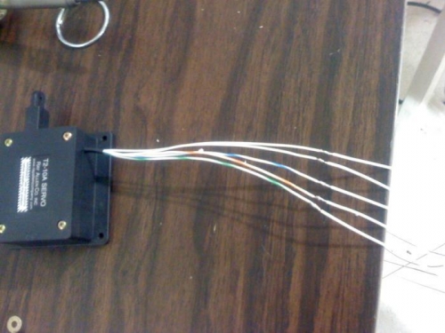

Brief Description:  Aileron Trim Servo Pigtails

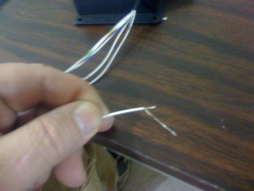

Set about wiring the leads for the aileron trim servo this evening. The servos come with a lead that is about 3 in long. I don't like to use butt slices if I can avoid them--probably pointless electrically, but my preference. So, what I did here (as elsewhere) was to use a NASA lash splice to extend the leads. They're strong, neat, easy to do, and hold themselves while soldering.
prepping leads
prepping leads
soldered
soldered
done
