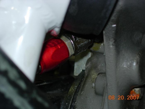

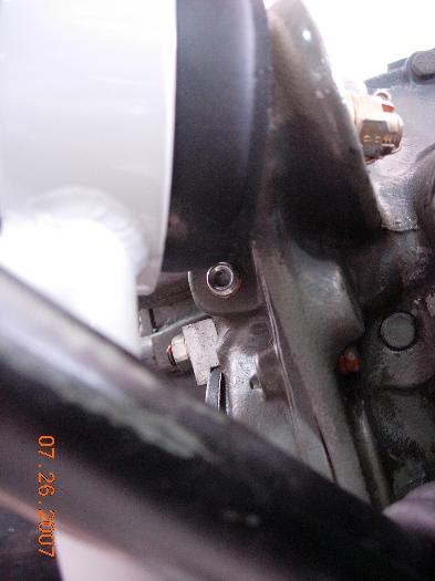

Anyway, I was able to get the pipe plug out of the port for the transducer line, but just couldn't get the elbow to turn. Yup, they were right.
So, I went through the drill again of dismounting the motor--but just the top two bolts. Let the motor droop on the mounts and slid the right top isolation mount out so that I could install the elbow. Got that done and installed the braided oil pressure line. Reinstalled the mounts.
