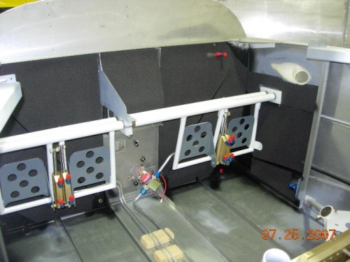

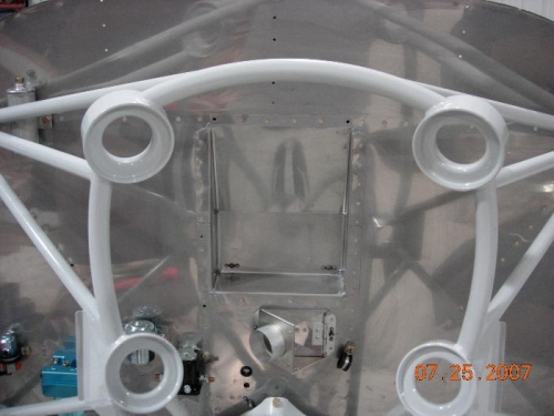

Brief Description:  Rudder Pedal Installation, Firewall Recess

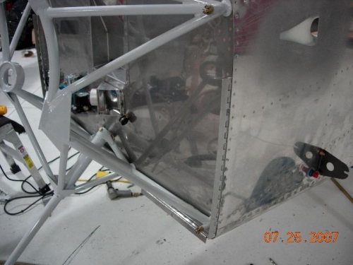

Installed the rudder pedal assembly, the rudder pedal support brace, and then the firewall recess. Also installed the sound deadener (after earlier painting the white bits black). Also installed the left and right fairing hinges to the firewall/skins.
Installed the motor mount, torqued the nuts, and installed the cotter pins. Installed the nose gear leg (greased it up good with axle grease) and torqued the retaining bolt. Set the break-away force of the nose gear fork to 22 lbs.
Pedals, Brace and Deadener Installed
Recess from front
Recess from front
Left fairing hinge, motor mount
