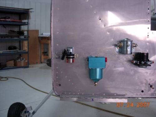

Installed the piano hinges for mounting the fairing today. Once I install the motor mount, I'll have a real hassle trying to get the hinges in place since there isn't much room for riveting. So I went ahead and installed the hinges and riveted the bottom skin to the firewall.
Installed the electric primer pump to the firewall. I took advantage of the gascolator doubler and installed the adel clamp for the pump there.
Fairing hinges
Fairing hinges
Primer pump
Primer pump
