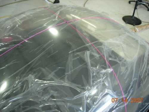

Brief Description:  Initial Layout and Trimming
Banner day today. I located the centerline of the canopy and cut off the moulding surrounding the canopy edge (pic 1). Once I cut the moulding off it got considerably floppier. The main idea of removing the moulding was to get some practice cutting on the plexiglass. It was pretty slow going.

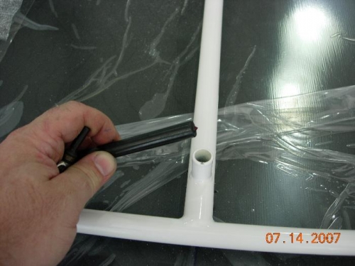

I positioned the canopy frame into the canopy to get the best fit. Pretty easy--the parts fit together very nicely right off the bat (pic 2). There is going to be a ton of trimming to get this to fit, though, since there is a lot of excess material.
