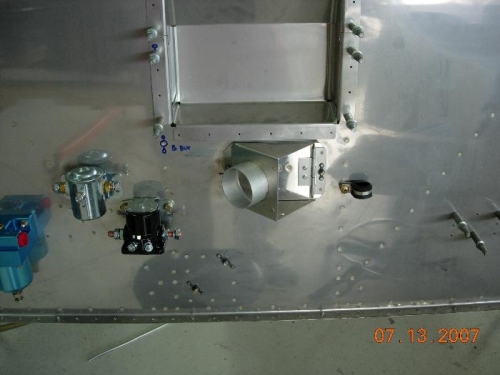

Brief Description:  Heater Shuttle
This is a very simple installation. It's just a triangular box with a door that swings closed and heat stays out of the cockpit, or open and it flows in through a 2 in hole I made in the firewall. It is controlled by a push-pull cable in the cockpit.
Shuttle Installed
Shuttle Installed
