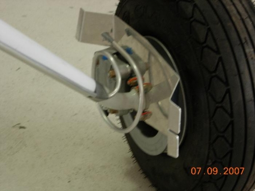

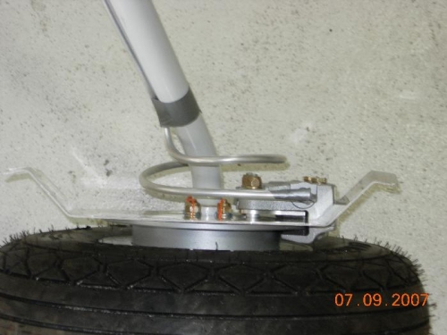

Pics aren't very good, but show the work.
These lines are attached at a fitting where the gear leg attaches to the fuselage. They run down the leg and are coiled before connecting to the caliper. I still need to install the 90s at the caliper and safety the caliper bolts. Later.
