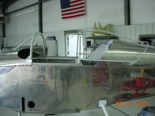

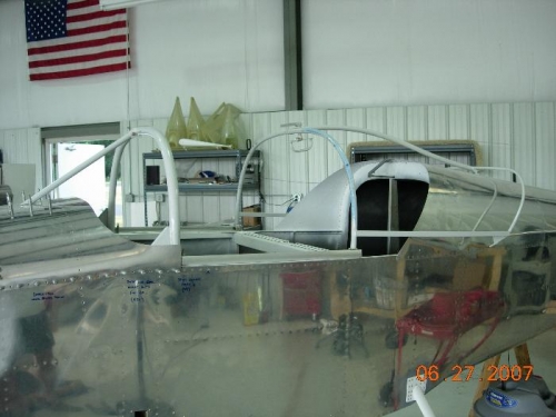

I thought that I'd never get back to the hangar to work on my plane. It's been 2 months and it really flew by. Work mostly kept me away, but really there was a little avoidance too. I did an initial fitting of the sliding canopy frame 2 months ago and was excited to be coming along so well. But, after the excitement came the realization that the frame was badly warped and was going to require a lot of work to make right. It was pretty discouraging. I really didn't know how to tackle it and a busy schedule kept my mind off of it.
I finally just decided to take the bull by the horns and go for it. My approach wasn't elegant, but I figured I would make the best of it and buy a new frame if I totally screwed this one up. My solution was to use a conduit bender! It fit the frame nicely and I could just use the concrete hangar floor as my bench. So, between the bender (tightening bends) and my feet (opening bends) I wrestled with the tough little frame until it fit pretty good. That was 15 hours of wrestling, cursing, and sitting slumped in the corner staring at the floor. I've learned a lot about the "black art" of fitting canopies, but have a long way to go.
At this point I have the frame fitting nicely. I've got the aft track installed and the side rails cleco'd in place. Next thing is to dust off the canopy itself and start cutting..,
Oblique View of Frame
Side View of Frame
Side View of Frame
