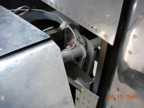

Brief Description:  Trim Servo Re-Do

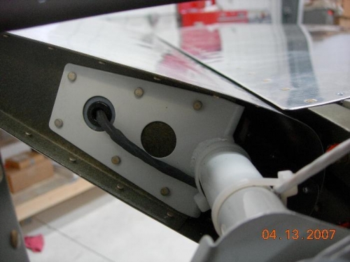

I really just hated the way I installed the trim servo power/indicator cable. I orginally ran it through the manual cable route and quickly learned that the cable would be a close neighbor to the trim servo jack-screw. It would have only been a matter of time before the jack screw munched through the cable and made my trim inop or run-away.
So, I sat and stewed and brainstomed about it. Once I had a plan I call Van's Aircraft tech support and discussed it with Gus. He gave me the nod and I installed it the way I show in these pics. The routing this way is far better since the wire enters the elevator almost adjacent to the trim servo pigtail. No binding, rubbing, sharp bends, etc--very clean. I like clean. I'm going to remove the snap bushing shown in Pic2, since it's too small to pass my inline connector through. I'll probably enlarge the hole and split a rubber grommet for this passthrough.
Pic3 shows the wire in relation to the vertical stabilizer. I still need to install the inline connector and lock it down and beefup the insulation to handle some chaffing at the cable ring.
Servo Installed
Servo Installed
New wire routing
New wire routing
View under VS
