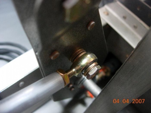

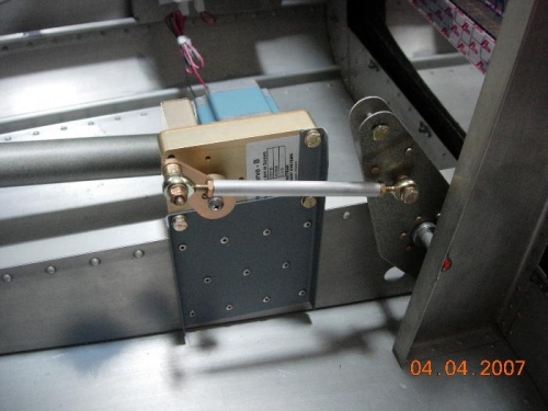

I installed the mounting bracket, servo, and the connecting rod for the autopilot pitch servo.

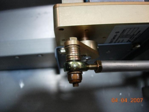

I need to redo the rod connections. The servo kit didn't come with enough hardware to install it, so I just added washers to get an idea of how things needed to be laid out (Pic2). I don't want the connecting rod to be set at an angle relative to the bellcrank--I want it to operate without binding at all. Now that I have an idea of how it should be rigged, I'll make some spacers to replace the washers.
Installed
Installed
Servo Arm
Servo Arm
Bellcrank tie-in
Bellcrank tie-in
