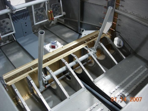

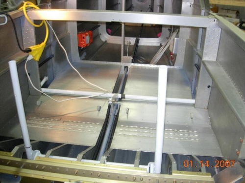

Began the process of installing the pilot and copilot sticks today. Everything went pretty well except that some of the nuts/bolts are a pain to get to.
I installed the control horn for the sticks and the interconnecting rod between the sticks. I also fabricated and installed the forward elevator push/pull tube. It connects the control horn to the elevator bellcrank just aft of the baggage compartment.
The sticks haven't been cut down yet and are ridiculously long. And, I need to align the sticks so that they are parallel.
