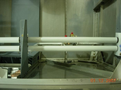

Brief Description:  Rudder Pedals Final Fitting
Finished up the fitting of the rudder pedal axles and the center support. Drilled holes for another mouning location that is 1" closer to the seats. I'm planning to mount the pedals in the most forward position and just use the seat as the adjusting point.

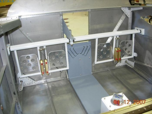

In picture 2 is a top down view of the pilot's rudder pedals. I mentioned before that the right pedal leans aft and the left one leans forward. You can see what I was talking about in the pic. SInce the pedal axles are fore and aft of each other, to have the pedals in alignment they need to be oriented this way.

Center Support Fitted
Pedal Alignment
Pedal Alignment
