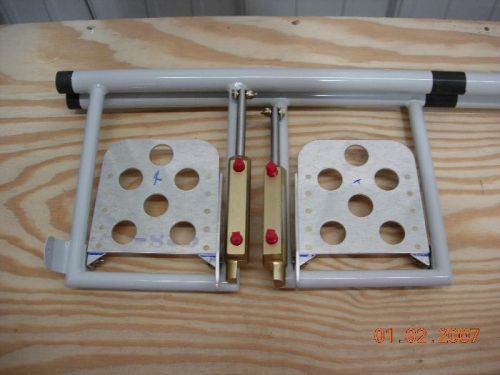

Brief Description:  Rudder Pedals
I've mounted the brake pedals to the rudder pedals and have gotten the brake cylinders partially installed (pic 1). The bottom cylinder attachments aren't finished yet--I'll need to mark the brake pedal arms for drilling from inside the cockpit. The left and right rudder pedals hang from separate axles (rods?) and are arranged fore and aft of each other. To have the brake pedals in the vertical position and aligned with each other, the forward (right) will lean aft relative to the vertical arm and the aft (left) will lean forward. So, the drill points on each brake pedal will be different to align them properly. Clear as mud, I know. I'll take a picture once I have them installed.
