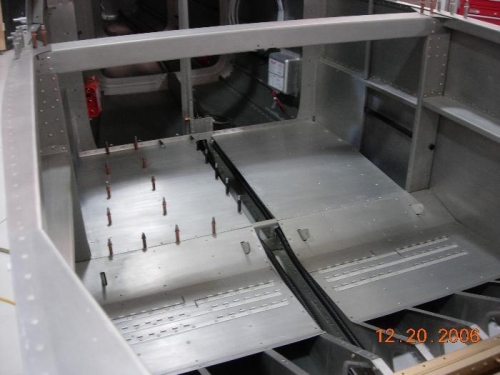

Brief Description:  Baggage Compartment
Once the steps were installed, I could close up the floor of the baggage compartment. The left side is rivetted in, while the right is just cleco'd for now.
The brace at the top of the pic is the seat back mount. There will be seats attaching at the 3 lines forward of that. The control tube runs down the open (for now) channel in the center of the floor.
Looking aft
Looking aft
