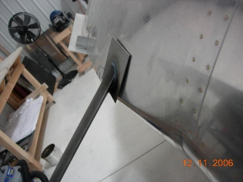

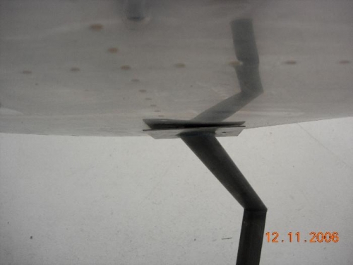

Left Step (cont'd)
Dry fit the step into the newly drilled hole. Much trimming needed to get it closer in--the weld on the step holds it out a bit from the skin. I opened the hole up a bit with an air nibbler and filed the step to even out the weld.
Initial Fit
Initial Fit
Initial Fit
